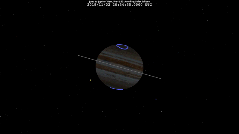

In this animated gif, you’re riding on the Juno spacecraft – now in orbit around Jupiter – as it approaches Jupiter. An orbit adjustment this week has ensured the solar-powered spacecraft won’t end its mission in Jupiter’s shadow on November 3. Here, you can see Jupiter’s rings and auroras. The distant sun is depicted as the yellow dot rising up just to the left of the planet. Image via NASA/JPL-Caltech/SwRI.[/TD]
