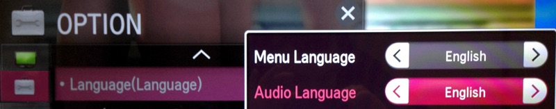

Changing audio language (for streams only, not VOD!)
Stream audio language is now automatically selected based on the Audio Language Settings (1st Audio) on your LG Smart TV (see picture below). If you have webOS TV, you will need to set webOS Video Mode to NC MPEG or NC Auto in App's Settings for this function to work. This function only works for streams that it supports (usually HTTP only, not m3u8).
Stream audio language can still be overridden by using the following codes in the TXT type of playlist:
epgCode,Channel Name,http://123.123.22.11:8000,ru
avi,Video pro Zajchika,http://www.quirksmode.org/html5/vide...buck_bunny.mp4,en
Using this parameter, the spicific audio language will be forced. In this case "ru" - Russian. You can check the audio tracks in VLC, language codes are listed here: http://www.loc.gov/standards/iso639-2/php/code_list.php
Examples: ru - Russian, en - English, de - German, lt - Lithuanian, et - Estonian etc..
The track change can be delayed up to 10 sec. Use only in case the TV selects inappropriate track. Could probably work on Multicast streams (UDP).

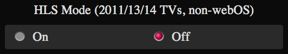

HLS Mode
HLS Mode sometimes helps open streams faster on older non-webOS LG TVs (except 2012 LM series). Just experiment with your streams and see if it helps.
