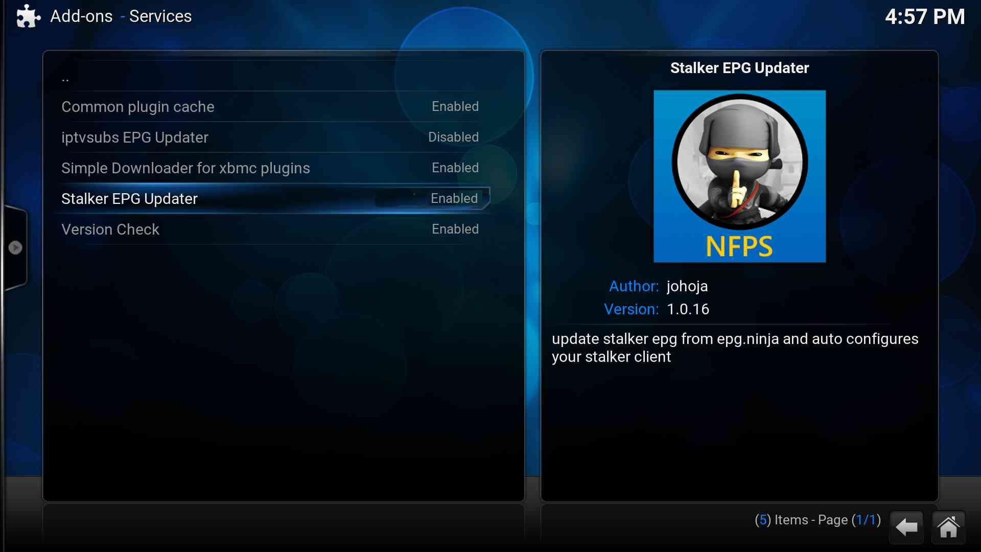

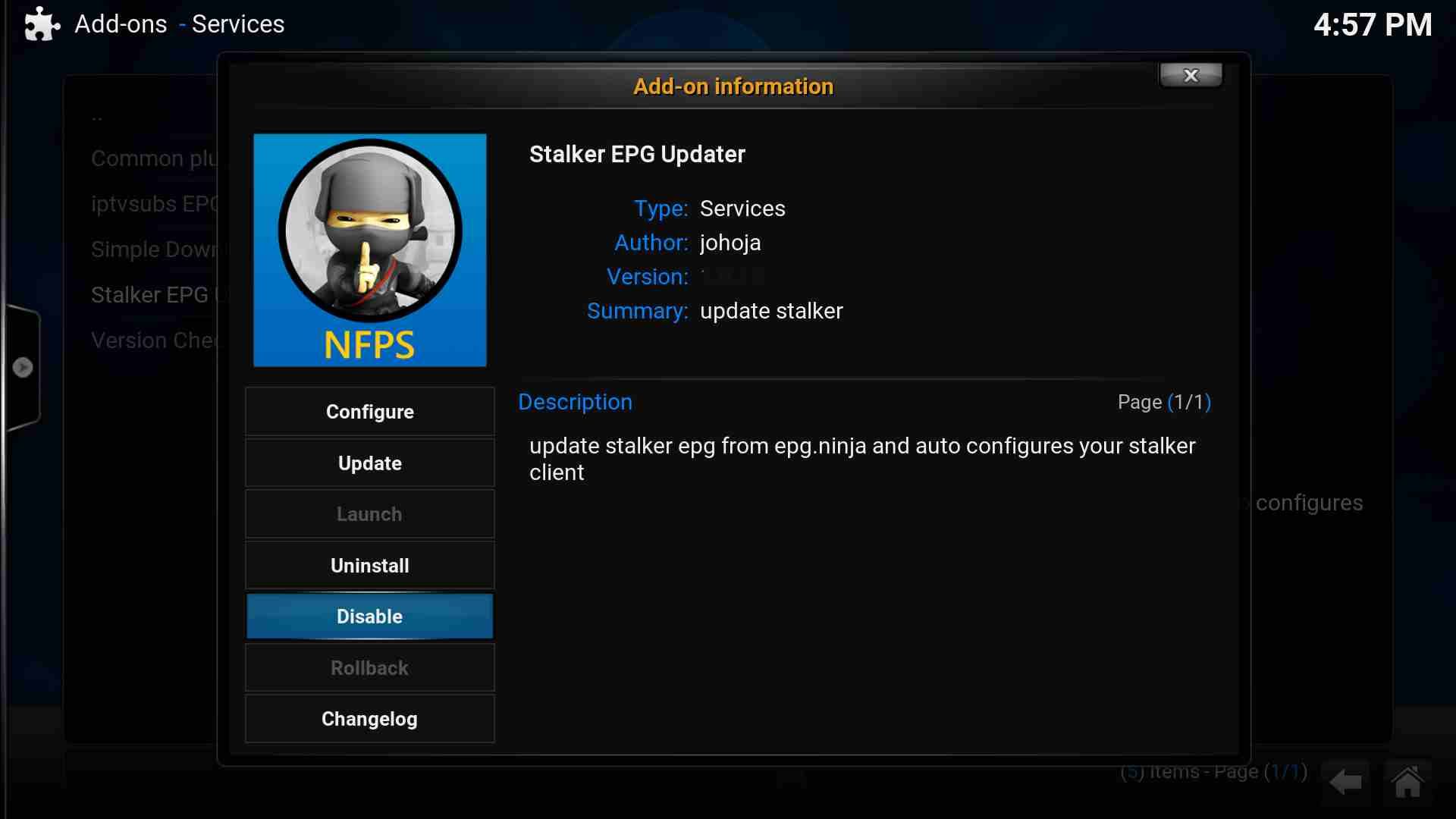

You can disable the updater when using the remote url. The updater has no bearing on this process.Code:http://nfps.**********

Condition 1 (You were using Stalker client NFPS):
If you had Stalker NFPS enabled, (1) Disable TV, (2) Disable Stalker NFPS, (3) Exit Kodi, (4) Do an IPTV Reset, (5) Start Kodi, (6) Enable PVR Stalker Client and configure it [instructions below], (7) In the EPG configuration portion, choose XMLTV only, Remote, and add the Remote URL that I posted earlier (and that is posted below), (8) In TV > General: Clear Data, (9) In TV > Guide: Clear Data, (10) In TV > General: Enable TV.
Condition 2 (You were using Kodi's built-in PVR Stalker client with the updater):
(1) Disable TV, (2) Disable the updater, (3) In the EPG configuration section, choose XMLTV only, Remote, and add the Remote URL that I posted earlier (and that is posted below), (4) Go to TV > General: Clear Data (5) Go to TV > Guide: Clear Data, (6) Go to TV > General: Enable TV.
